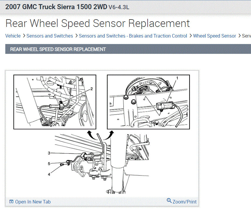

When i come to a stop or rolling my brakes screw up ,almost feels like the abs goes in and out ,,dry roads and all does this about 4 out of ten times..there should be a recall for this but there is not.I dont have alot of money havent worked since june.So can i diconect my abs fuse or will my brakes just not work at all and hit some one..Please tell me what I can do and what can happen

Yes, you can remove the ABS fuse. The brakes will then function as non-abs brakes. However, you may want to check the wheel speed sensors to locate the one that is causing the issue.
If you take a look through this link, it explains how to test a wheel speed sensor. Take a look.
https://www.2carpros.com/articles/abs-wheel-speed-sensor-test
If you find one that is bad, here is a link that shows in general how to replace it:
https://www.2carpros.com/articles/how-to-replace-an-abs-wheel-speed-sensor

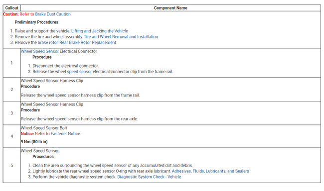

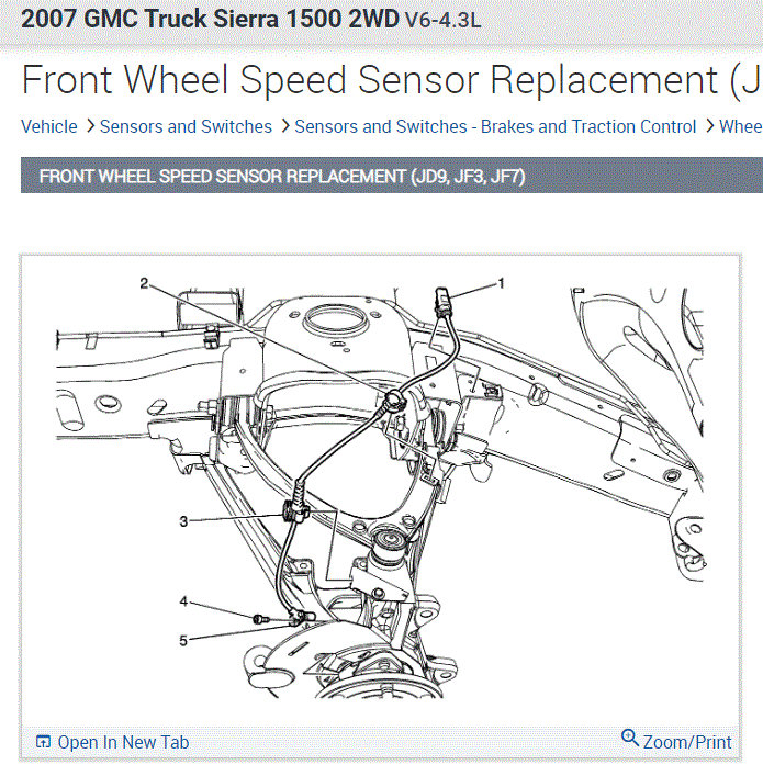

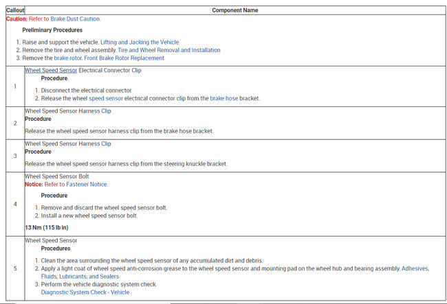

If you decide to replace one or more, the attachments below include the directions and pics specific to your vehicle for replacement. The first two pics are for a rear sensor. Pics 3 and 4 are for a front sensor.
See pics below
