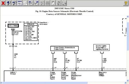

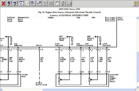

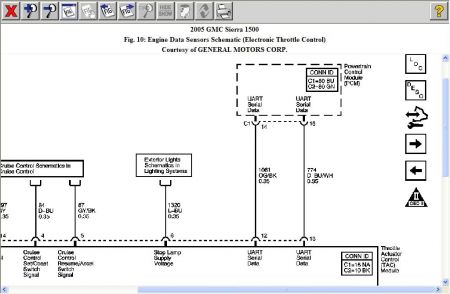

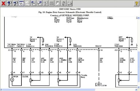

I'm looking for a wiring diagram for an 05 ish Gm 5.3 v8 throttle by wire setup. Im not repairing a vehical but using the throttle body as a giant air valve of sort.. i need to know were to switch power and ground. to allow the throttle plate to be fully opened. Any help would be appreciated..

Hi muddinguy, Thank you for the donation. I have the schematic diagram here but I do not know how to upload the file and the complete diagram is too small so I have split them into 4 pcs after blowing up the size. Hope it is what you are looking for.
https://images.2carpros.com/forum/automotive_pictures/192750_ThrottleSchematic05GMC01a_1.jpg
https://images.2carpros.com/forum/automotive_pictures/192750_ThrottleSchematic05GMC01b_1.jpg
https://images.2carpros.com/forum/automotive_pictures/192750_ThrottleSchematic05GMC01c_1.jpg
https://images.2carpros.com/forum/automotive_pictures/192750_ThrottleSchematic05GMC01d_1.jpg
