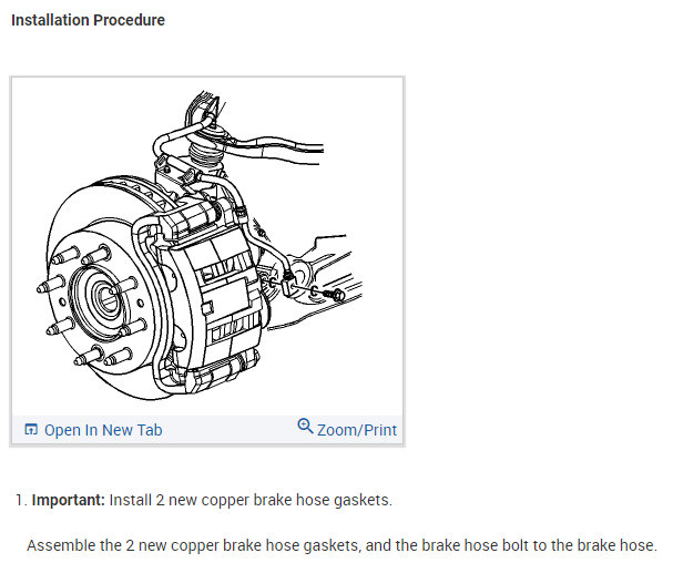

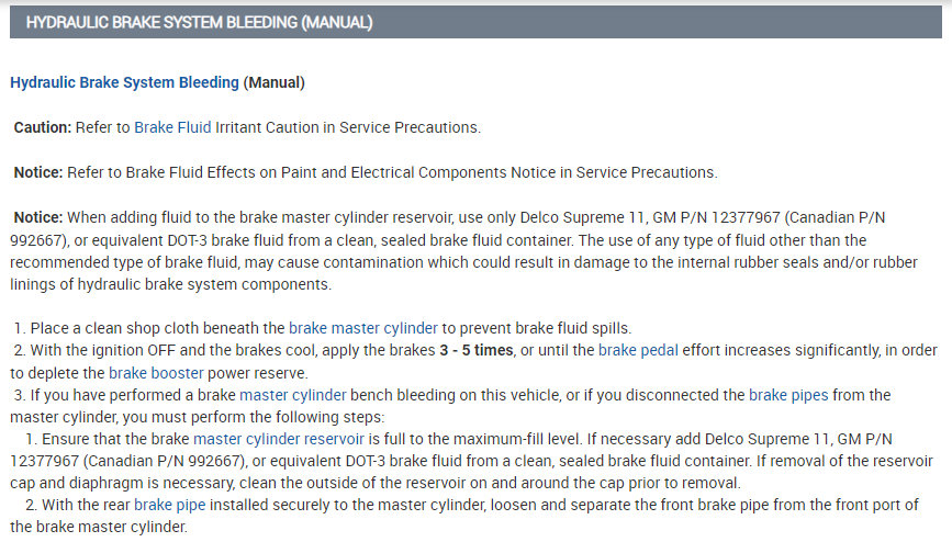

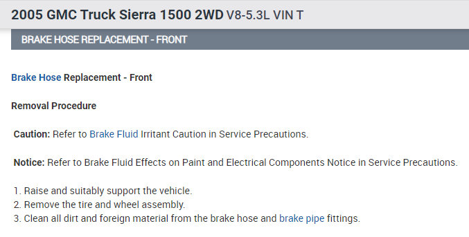

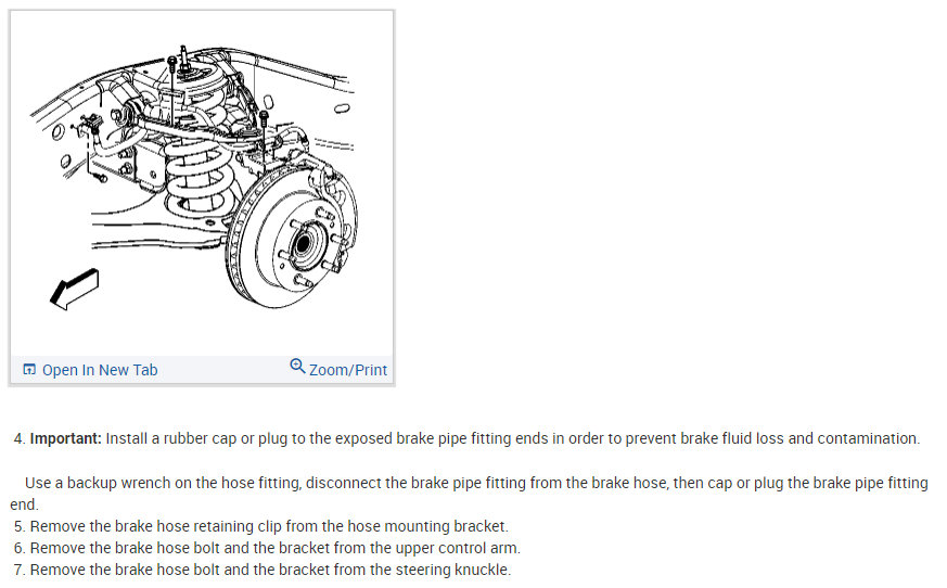

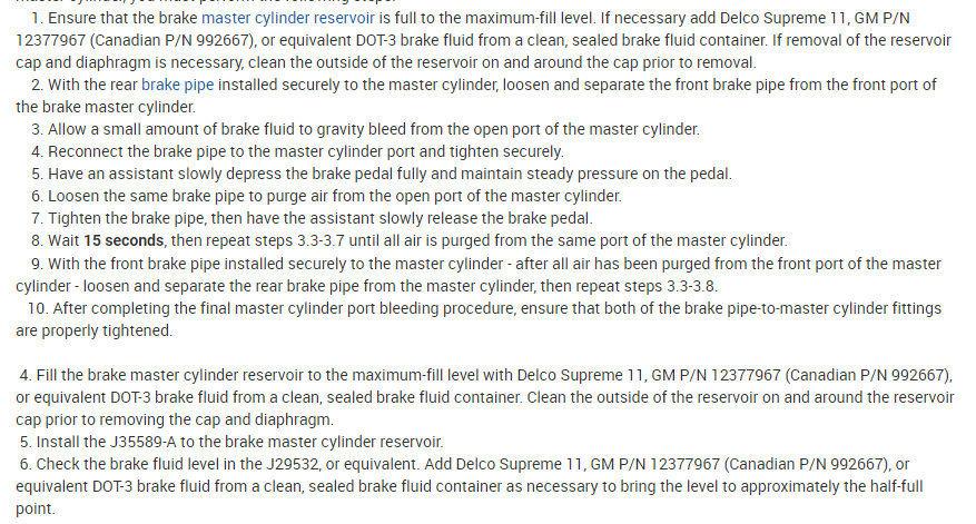

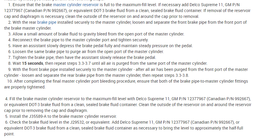

my brake pedal goes tot he floor the right front brake hose is leaking can you help me please?
Feb 24, 2009 at 4:51 PM
DANNY L
  • 5,648 POSTS
Hello, I'm Danny.

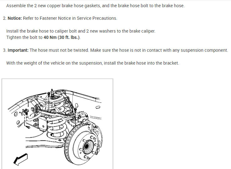

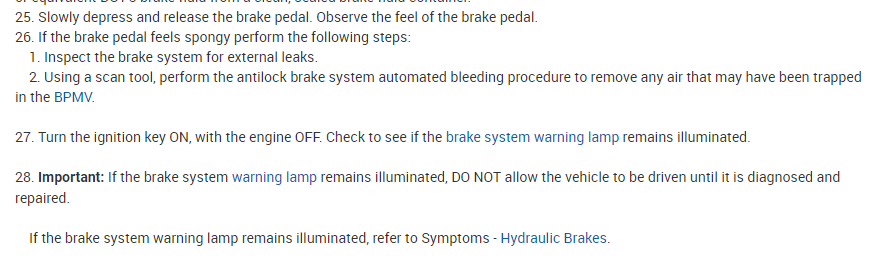

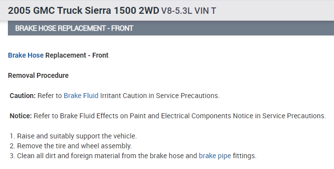

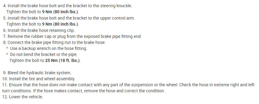

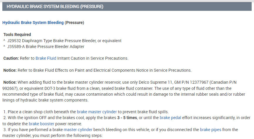

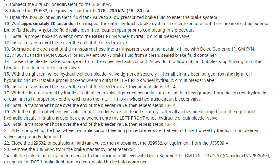

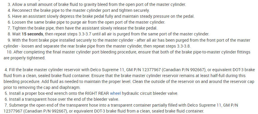

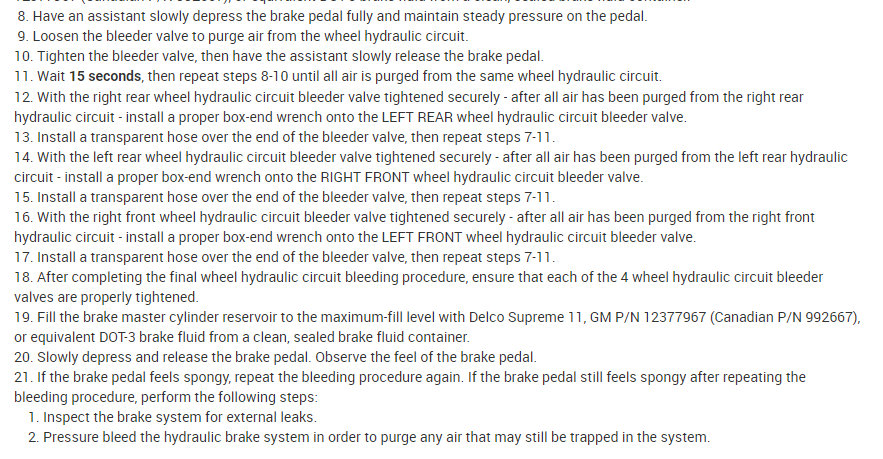

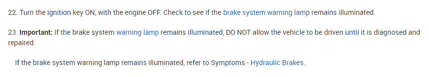

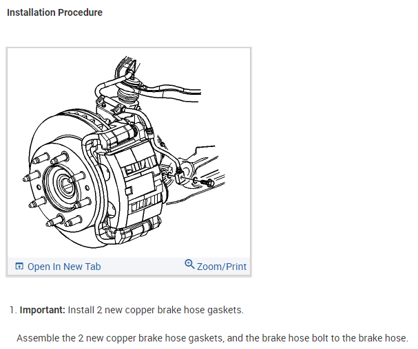

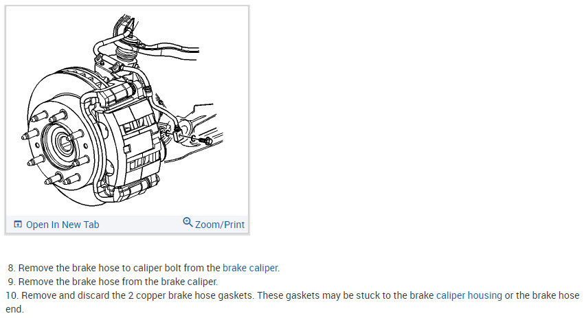

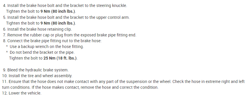

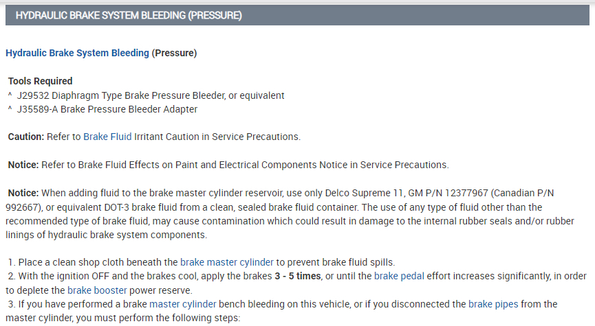

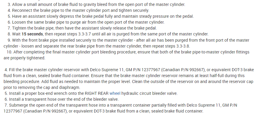

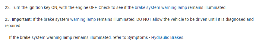

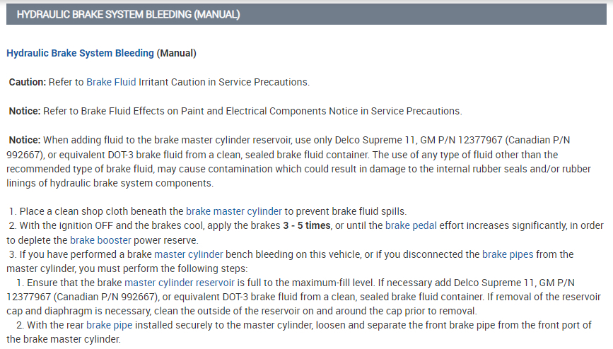

Here is the information you requested. Here is a guide to help you step by step with instructions in the diagrams below to show you how on your car how to bleed the brake system after replacing the brake line: Here are videos to help you make your own line or replace the brake flex hose.
https://youtu.be/sO43p4ZFUiM
and
https://youtu.be/1Prs_coIuCg
The process is the same in most cases.
https://www.2carpros.com/articles/how-to-bleed-or-flush-a-car-brake-system
I've attached picture steps below on how to change the front brake line on your truck and the brake bleeding procedure. Hope this helps and thanks for using 2CarPros.
