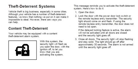

what is the light on dash for...looks like front of truck with padlock on it locked?

Does it look like this? Content theft deterrent,
https://images.2carpros.com/forum/automotive_pictures/512072_content_theft_deterent_1.jpg
Here is a guide to help you reset the system https://www.2carpros.com/articles/how-to-reset-a-security-system Please run down these guides and report back.
