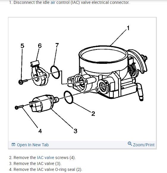

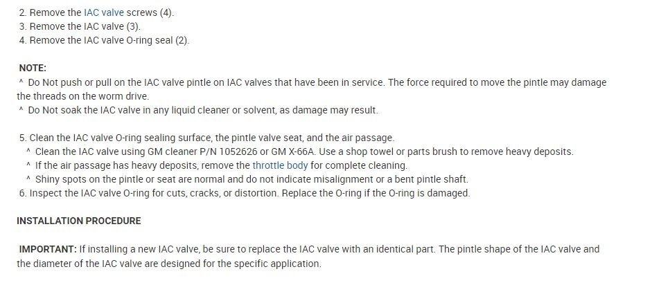

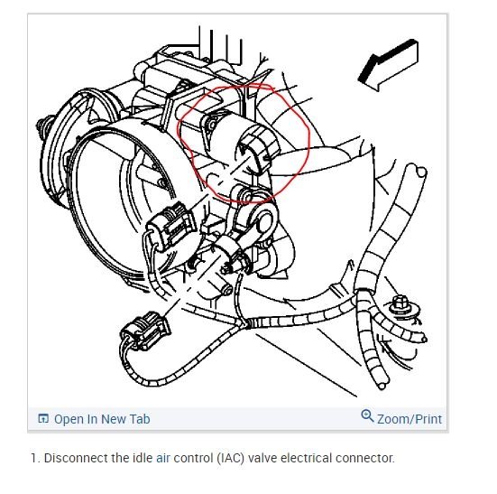

Just changed out my IAC valve. Do I require a computer reset or will it reset automatically?
Wednesday, April 15th, 2009 AT 7:29 PM
MECHANIC
52,796 POSTS
Good afternoon,
No, there is no relearn. The ECM will adapt to the engine's idle speed.
https://www.2carpros.com/articles/how-to-replace-an-idle-speed-control-motor-iac
I attached the procedure below for you to view.
