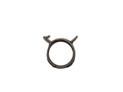

Who makes and sells a tool to release the DORMAN connectors which hold the heater hoses to the heater coil? I tried several auto parts stores and only found fuel and A/C quick disconnects. No luck on GMC or Chevy heater hoses.

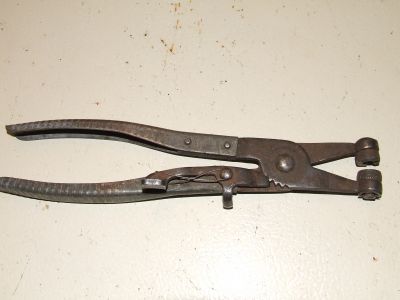

If this is your clamp I use either regular pliers, or water pump pliers, depending how big it is.
https://images.2carpros.com/forum/automotive_pictures/62217_clamp_001_1.jpg
https://images.2carpros.com/forum/automotive_pictures/62217_Water_Pump_Pliers_1.jpg
If this is not the clamp you are talking about, disregaurd! Tim's tool co calls them Flat band pliers.
https://images.2carpros.com/forum/automotive_pictures/62217_Flat_Band_Pliers_1.gif

Actually Tim the top pliers are mine and the bottom came from the tool co you recommended...10 seconds to find it!
