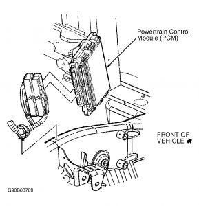

Haven't had a chance to check with volt meter yeat, but just out of curiosity, where is the pcm located ?
Jul 30, 2010 at 8:02 AM
DOCFIXIT
  • 18,828 POSTS
Underhood
https://images.2carpros.com/forum/automotive_pictures/198357_Graphic_539.jpg
