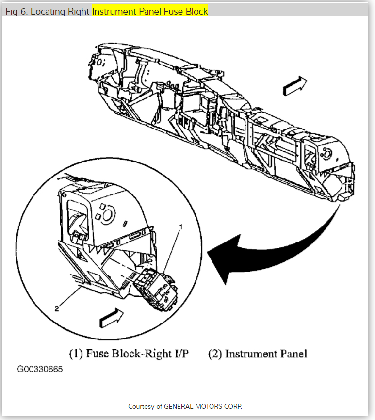

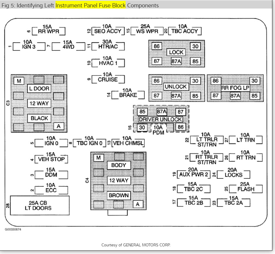

It sounds like the fuel pump relay needs to be checked here is a guide and the reay location so you can run the test.
Cheers
