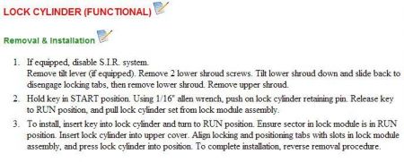

Hi I need to replace the ignition lock cylinder on my truck and I don't know how to do that. If you could find a way to graphically describe the process to me that would be great.

see if this helps..
https://images.2carpros.com/forum/automotive_pictures/261618_Noname_828.jpg
