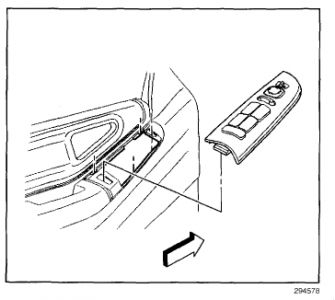

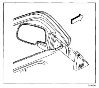

How do I remove the following:
power accessory switch panel
trim panel upper extension
Regards-
Chuck Osborne

https://images.2carpros.com/forum/automotive_pictures/30961_door_1.jpg
Open the front door. Release the upper extension by pulling outward in order to release the upper retainer clip. Remove the upper extension from the trim panel by lifting up and out.
https://images.2carpros.com/forum/automotive_pictures/30961_switch_1.jpg
Insert a flat-bladed tool into the slots on the power accessory switch panel in order to release the retainer clips. Remove the switch panel. Disconnect the electrical connectors from the switches. Remove the screws from the switches. Remove the power accessory switches from the switch panel.
