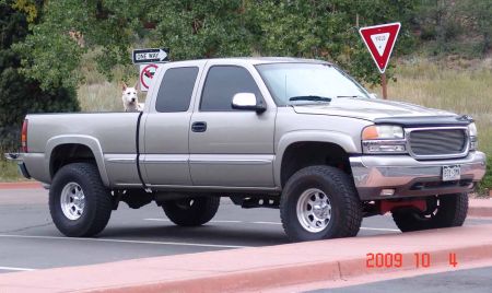

I'm wondering how hard it is to change the seals out of my leaky GMC differential... also wondering if there is somewhere I can find instructions on how to do the job. Any ideas?[img:7309e1cd29]http://www.2carpros.com/forum/automotive_pictures/464215_truck2_2.jpg[/img:7309e1cd29]
