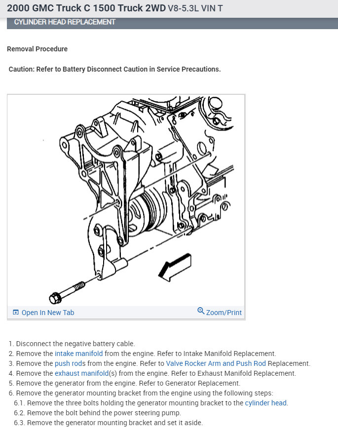

I've been loosing coolant when you take the oil cap off there is a yellow milky subject around the cap. there is no indication of water in the oil. could it be the intake gasket or something major like head gasket, there's no water leaking out of the exhaust and no misfires.
