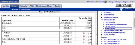

my owners manual says to gap the plugs to .060, but the spark plugs i purchased say to gap them at .040. I double checked and they are the correct plugs. Out of the box the plugs are at about .042. What should i do

Gap it at .060
https://images.2carpros.com/forum/automotive_pictures/12900_gap_1.jpg
