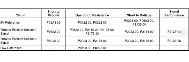

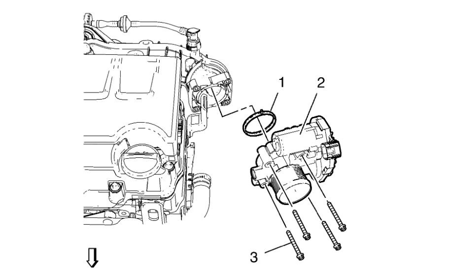

Code reader said P0122, so he changed the TPS, & a blown 40amp fuse, cleaned battery terminals, changed plugs and wires, fuel filter, IAC, cleaned the throttle body, MAF, and EGR. He's checked for a vacuum leak, and voltage to TPS.
When he disconnects the TPS and IAC and starts it, it idles just fine for a few minutes, then idles low again.

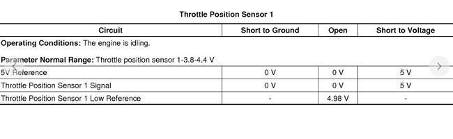

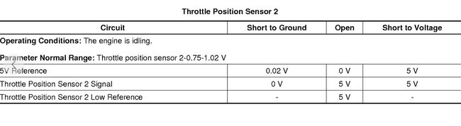

What is the TPS voltage with the throttle closed?

I believe it was 5 volts.
