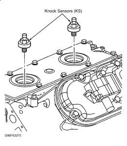

I believe your truck has an anti-knock sensor on the right side of the block by the starter, it is round about 2 1/2 inches in diameter, with one wire going to it, it's supposed to work under load only!!!, so get on Mitchell 1 and find out how to diagnose it....I got on Mitchell 1 but I cannot find anything on the anti-knock sensor can you check and see if you have one on your truck? and get back to me.
May 21, 2009 at 5:51 AM
OBXAUTOMEDIC
  • 3,711 POSTS
The Knock Sensors are located in valley under Intake Manifold... This is the location for both 1500 & 2500 series and all V8's....
https://images.2carpros.com/forum/automotive_pictures/188069_99gmcsierra1500knocksensors_2.jpg

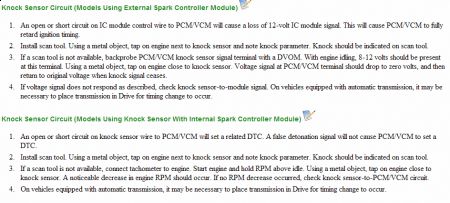

Here is Test Proceedure....
https://images.2carpros.com/forum/automotive_pictures/188069_99gmcsierra1500knocksensorstest_2.jpg
