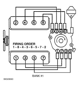

In laymens terms how do I connect the plug wires to the distributor cap correctly, what plud goes where on the cap IE: looking at the motor from front of truck passenger side "left" plug closest to me #1 where does that plug wire go on the cap? Etc left side to include coil wire, and same for right side #1 plug to last plug, Plz help as It wont run, and I need to work tomorrow morning at 6 am

There you go:
https://images.2carpros.com/forum/automotive_pictures/12900_fo_163.jpg
