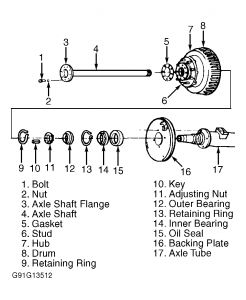

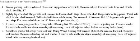

How do I remove the rear brake drum of a 1997 gmc sierra dually to replace lug bolts
May 21, 2010 at 8:57 PM
2CARPRO JACK
  • 11,533 POSTS
First lift and support the vehicle.When the drum is off you may want to have a machine shop press the old stud out and the new one in, so as not to damage the new threads
