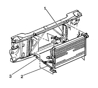

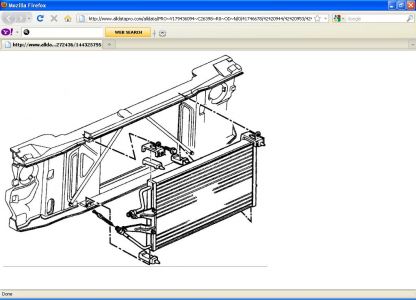

where is the orifice / expansion tube located on a K 1500 Full size P/U
Sep 4, 2010 at 4:16 PM
SATURNTECH9
Experienced Mechanic
30,869 POSTS
It's in the bottom condensor line.
Sep 4, 2010 at 7:16 PM
DGRIVETTI
MEMBER
1 POST

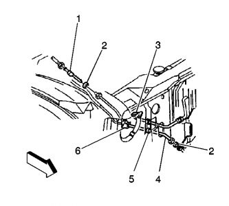

On the AC unit where is the orfice tube installed on a 1998 gmc 1500 pickup truck 4wd v8 350
Jan 29, 2021 at 2:28 AM (Merged)
CLY
308 POSTS
I can show you a picture of where it is located... With C60 option.The orifice is #3
With C69 option.The orifice is #1
Hope this helps... Cl
