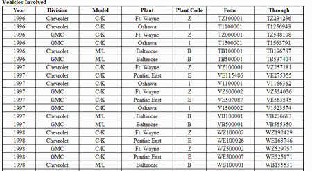

How did it go bad? There was a recall on coil wire routing on 4.3 engines that caused a misfire condition, this if left unrepaired caused converter failure. seems the fix is to reroute the coil wire so it's runs over the top of the plug wires to the coil. It was too close to metal brackets and tranny filler pipe.
https://www.2carpros.com/forum/automotive_pictures/62217_Recall_Converter_1.jpg
I would think if you get the right cat for the truck, aftermarket or OEM should work.
