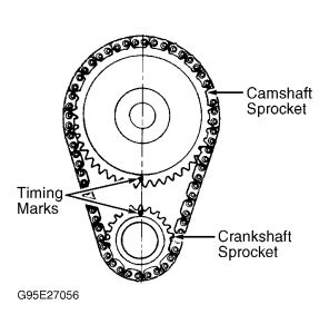

i know where the mark on the harmonic balancer is but i cant find the tdc/0 mark. i was wandering if you could give me an accurate discription as where to find it

too many engine choices...which one are we talking about? 5.0L, 5.7L or 6.5L diesel?

it is a 5.7L

BASE TIMING The distributor ignition system has no provision for timing adjustment. The base timing is preset when the engine is manufactured and no adjustment is possible. The distributor may need adjusting to prevent crossfire. Refer to Camshaft Retard Offset Adjustment See: Ignition Timing > Adjustments > Camshaft Retard Offset Adjustment Ignition timing can only be changed by reprogramming the PCM using Techline Information System 2000 (TIS 2000) PC, and the Tech 2 scan tool. Please contact your dealer for necessary updates and procedures. timing marks for the timing chain are below, you will want to use a compression gauge / compression whistle to get to TDC first .
https://images.2carpros.com/forum/automotive_pictures/261618_Graphic_596.jpg
