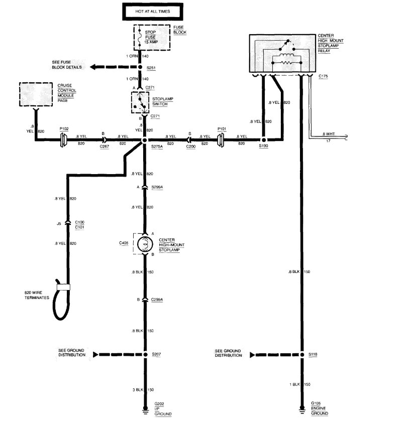

I just replaced the brake switch on my pickup following the instructions and after replacement, it still doesn't work. In fact, I don't even understand how the switch can work. If the brake light switch AND the plunger that goes into the master cylinder AND the brake pedal is moving, how can the brake pedal push the button that turns on the lights (without the switch being rigid and attached separately from the rest of the components)? In other words, everything is moving together.

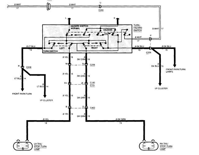

Make sure you have switch adjusted correctly. if new switch didn't fix issue than check wiring. if wiring is good than suspect faulty turn signal switch as the brake light wiring runs through the signal switch. Here is a guide to help with the brake light switch replacement guide and wiring to help fix the problem

https://www.2carpros.com/forum/automotive_pictures/261618_Noname_2718.jpg
https://www.2carpros.com/forum/automotive_pictures/261618_Graphic_704.jpg

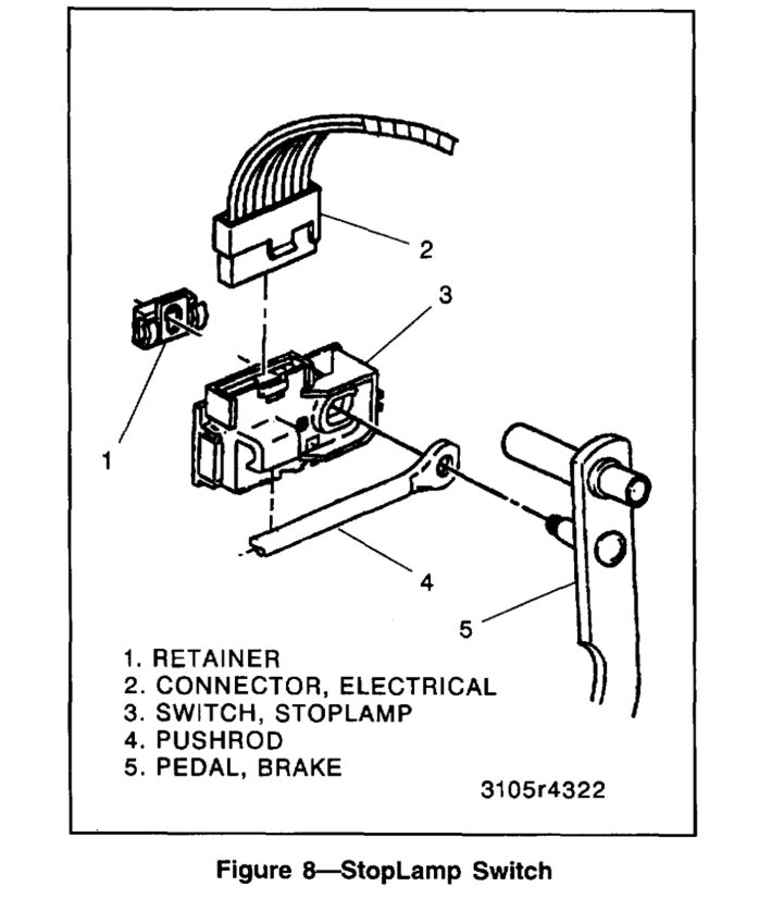

The pix you have attached is the wrong switch. I failed to mentioned that I have a Sierra PU. The capture I have attached is the correct switch.
https://www.2carpros.com/forum/automotive_pictures/577797_Capture_1.jpg

Diagram I posted is for the sierra pickup, do you have cruise control?

Okay, heres how you adjust that type of switch then. There should be a small switch nipple that rests against the brake lever arm. That can be adjusted by depressing it hard until it clicks into another position. Try to adjust it that way and see if it helps.

If you look at my pix, you will see a hint of a gold-colored 'trigger' (inside the hole) that lays against the pivot point on the brake pedal. When the pedal is depressed, it is suppose to push the gold 'trigger' into a plastic slide-switch which, inside the switch, engages/disengages up to six contacts.
I tore the old swith apart (I'm good at that) and there is no intermittent steps that the slide can stop at. The plastic spring-loaded slide only slides forward and backward along a track doing it's work. There is no adjustments at all on this.
In fact, it is an extremely simplistic (cheap) switch.

Ok I see whats going on here, you have this posted as a 1994 but the switch you are showing me is the newer style such as 1996 sierra. The newer style does not have adjustments. With the brake pedal in the relaxed position (no pressure applied to the pedal), the contacts of the switch should be mounted up against the pedal stop on the pedal housing. When pressure is applied to the brake pedal (as if braking), the contacts of the switch "close" thus closing the circuit and energizing the brake lights.
Is your switch positioned properly. Such that the contacts of the switch are positioned up against the pedal stop?

OK boys and girls. I have figured it out.
When I installed the new switch, somehow I cocked the gold trigger -- it came out of it holder. In this position, it was not pushing on the slide-switch properly and therefore, would not engage the stop lights.
I took it off again, found the problem, fixed it and reinstalled it. It is working just fine now. I have no idea how I did this but, once again, I screwed something up.
