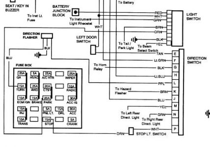

I bought this truck and when i turn on the headlights i loose my turning signals and taillights. The blinkers work when the lights are off. i obviously only can drive during the day. I also had an 89 chevy with the same problem. I wouldn't think it would be a coincidence I bought two vehicles with the same problem, other people had to encounter such issues. Do you any ideas as to what if causing this. I changed the entire steering colunm and nothing changed. It is driving me nuts, any help would be greatly appriciated. Thank you

Welcome to the forum, if the headlamp switch is on the dash and the dimmer is on the steering column, there should be a multiwire connector under the dash close to steering column, for circuits going to and from the steering column. You should be able to test voltage circuits there, using a testlite. Your headlamp switch probably has two circuits, one is a circuit breaker, only for the headlamps, red wire carries voltage for that. The other circuit is a fused circuit for tail lites--dash lites and stuff. orange wire carries voltage for that. You can also see that the yellow wire carries voltage to the dimmer, I believe. At the headlamps themselves, lite green wire is voltage for high beam. Tan wire is voltage for low beam.
