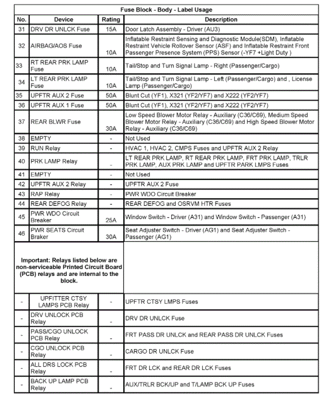

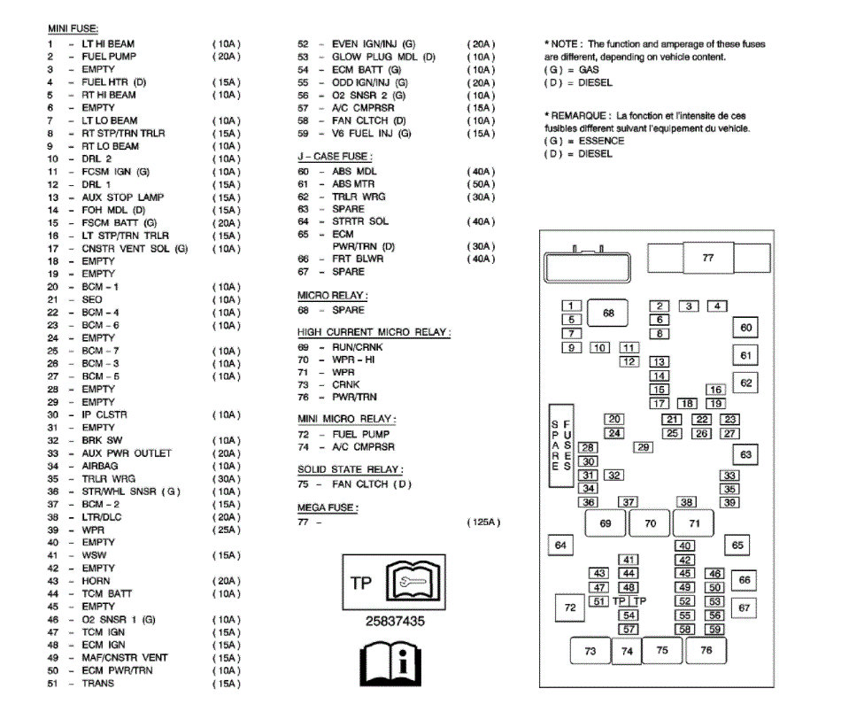

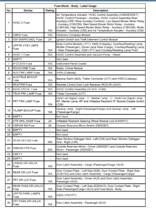

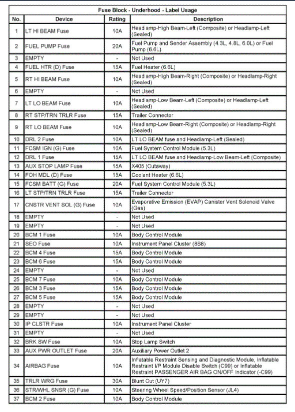

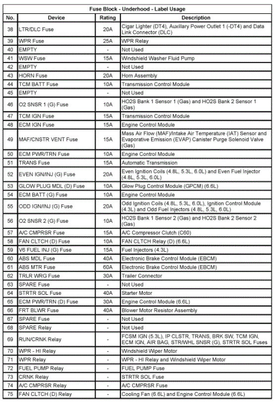

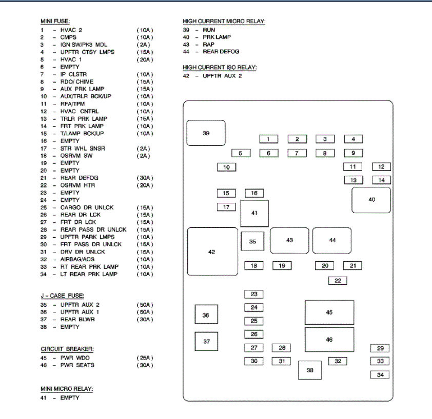

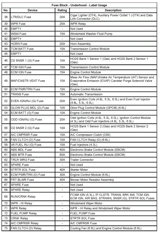

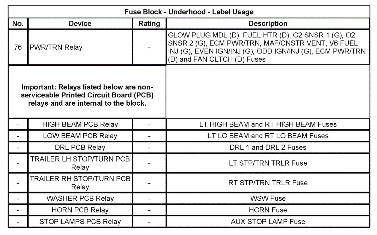

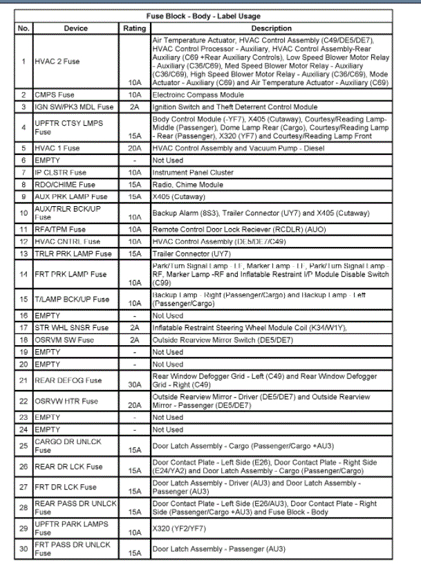

Where is the fuse panels located and what do the fuses go too???
Feb 15, 2010 at 12:36 AM
  • 110,240 POSTS
If you look at the attachments below, they provide the fuse box orientations and what each fuse is for.
In addition to just checking a fuse, make sure there is power to it. A fuse may be good and not be receiving power.
