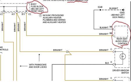

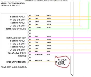

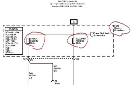

There are several inside lights that don't work, none of the cigarette outlets work, and the left side of all speakers don't work, so I'm guessing it's a fuse issue (hopefully). Just bought the van, so it's never worked. Manual says the fuse box is "on the drivers side" and I found it under the driver's seat. But I cannot get to it at all! I cannot even open it. How does one get to that fuse box? Also would appreciate any know-how if you don't think it's a fuse issue. Thanks!!
