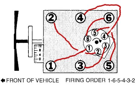

What is the firing order for a 1988 GMC Safari 4.3 V6 non Vortec? Also need Firing Diagram.
