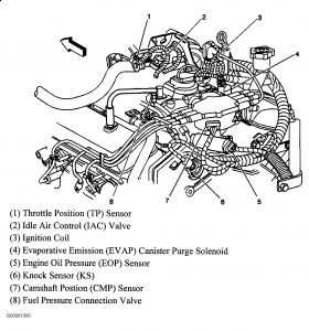

I'm trying to set the idle on my safari van and was wondering how I can set up a tachometer to it? Thanks.

Idle not adjustable is controled by PCM via Idle Speed Controler

What would cause it to idle too low most of the time? Is there a way to hook up a tach anyway?

The IAC valve maybe carboned up remove and clean with carb cleaner passageways too. If no check engine light on then carbon likely. Also look for any vacuum leaks. as for TACH not sure check with like Summit see what they have.
https://images.2carpros.com/forum/automotive_pictures/198357_Graphic_443.jpg

Thanks for the help. I will try and clean out the IAC with some carb cleaner or something. May I as where you obtained that picture?

Mitchell OnDemand.com
