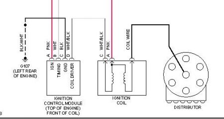

i got voltage off the pink wire.but i cant get a pulse from the white wire.what can i check now?

hi, I'd check trouble codes. At the least, you need an obd11 codes reader. The white wire at ignition module comes from pcm, pulse, engine cranking. Pink is voltage, black is ground. White wire with black tracer, pulse, goes from module to coil. I want to check for rpm signal.
https://images.2carpros.com/forum/automotive_pictures/170934_ignition_module_1.jpg
