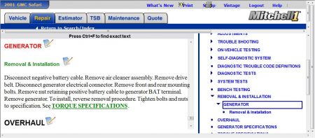

how do you change the alternator on GMC Safari Van. What needs to be moved out of the way.

https://images.2carpros.com/forum/automotive_pictures/12900_alty_44.jpg
