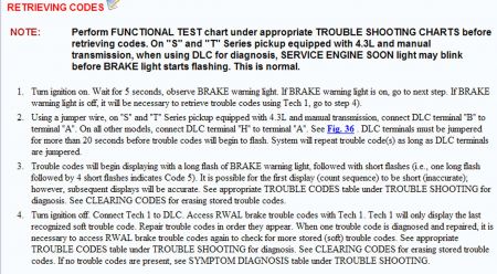

On my 1993 Jimmy S15 4x4 4 door 4.3L CPI vortec, the ABS light always comes on and flashes a code 38, according to my book it is a left rear wheel speed sensor. I know there is one at each front wheel but I looked all over the back and can't seem to find it anywhere. If anyone knows where the rear wheel speed sensors on my truck are located I would really appreciate it if you can put me in the right direction. When I brake the pedal pulses and is hard to push then all of a suden it kicks in. That don't happen all the time though, only once in a wile during a drive. At the same time it happens you can hear a noise in the front end almost like a hydrolic pump sound trying to work. I would like to check my wires and clean the sensor before I spend hundreds at a service center. Once again I would appreciate any advice or help you can offer. Thank You

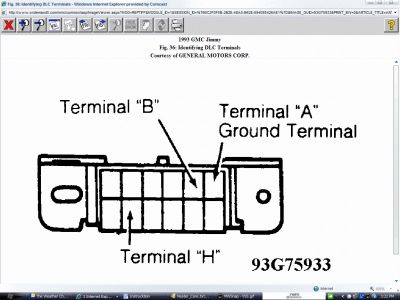

I searched the rear end for hours and the only things that are on the rear diff is my emerg brake and brake lines, they run across. On the backing plates on the rear has only the emerg brake and the brake line coming out of them. When I jump the wires as to the hilton book, my abs light flashes 3 times and then 8 times which is a code 38. The book says it is a left rear wheel speed sensor. I also looked on the net and the gm code reader says the same thing, but for some reason I can't seem to find it in the back at all. I can't even find the spot where one would go. Would it be located somewhere else besides those two locations as I can't find it if my life depended on it. Well I guess my life does depend on it when I think about it. Well PLEASE anyone with any ideas or sugestions would be greatly appreciated. Thank you

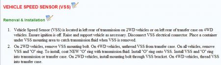

I found a few things for you, look on the transfer case for the VSS this is the sensor for RWALB
https://images.2carpros.com/forum/automotive_pictures/62217_DLC_1.jpg
https://images.2carpros.com/forum/automotive_pictures/62217_Codes_3.jpg
https://images.2carpros.com/forum/automotive_pictures/62217_VSS_2.jpg
