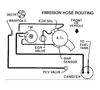

1990 GMC S15 4 cyl Two Wheel Drive Manual
how to figer out the conections to the vacum system connetced to air breather and fuel system
Jan 5, 2009 at 1:44 AM
JDL
  • 16,098 POSTS
https://images.2carpros.com/forum/automotive_pictures/170934_1990_gmc_1.jpg
This is for a 89 gmc 4 cylinder, all I found.

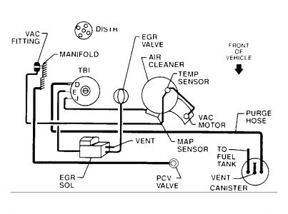

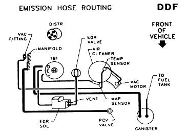

There is one for Fed adn one for CA emissions and for differnet transmissions
https://images.2carpros.com/forum/automotive_pictures/1639_gmc_1_1.jpg
https://images.2carpros.com/forum/automotive_pictures/1639_gmc2_2.jpg
