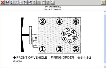

Engine Performance problem
1989 GMC S15 6 cyl Four Wheel Drive Automatic
what is the firing order for 6 cylinder spark plugs
Mar 26, 2009 at 7:34 AM
  • 75,992 POSTS
Here you go
https://images.2carpros.com/forum/automotive_pictures/12900_fo_41.jpg
