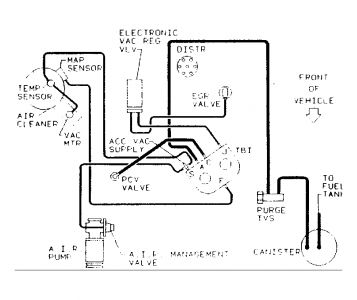

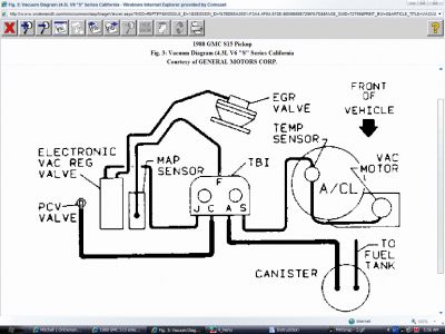

diagram of emission lines going to vacuum resiavor.
and other areas.

Top=2.8 Bottom=4.3
