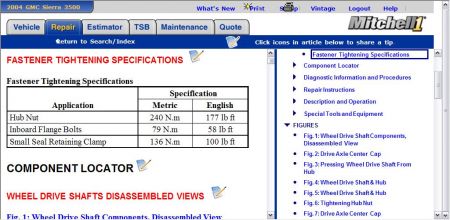

I have a 2004 gmc w5500 medium duty truck and have just packed my wheel bearings and need to know the spindle nut torque for a truck this size any help would be greatly appreciated

At your request and have a nice day see below
https://images.2carpros.com/forum/automotive_pictures/12900_hub_1.jpg
