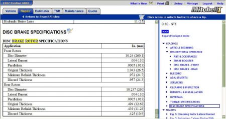

i have a 1987 gmc 6000 topkick, i have at a shop they are telling me i need all four rotors because they are under discard limit. i need to know what the actual spec is for these rotors, i had them replaced two year ago, the truck has 4 wheel disc,427ci engine with manual trans, thank you
Sep 6, 2007 at 8:12 PM
  • 75,992 POSTS
See below for the specs.
https://images.2carpros.com/forum/automotive_pictures/12900_disc_rotors_pontiac_6000_specs_1.jpg
