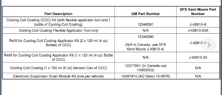

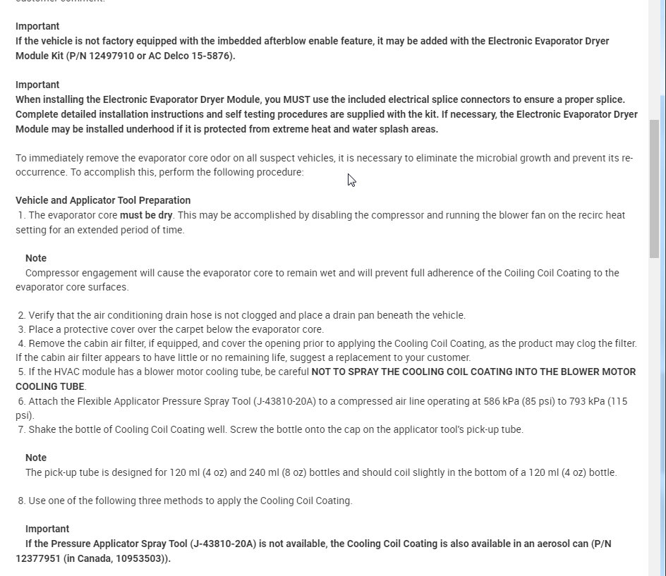

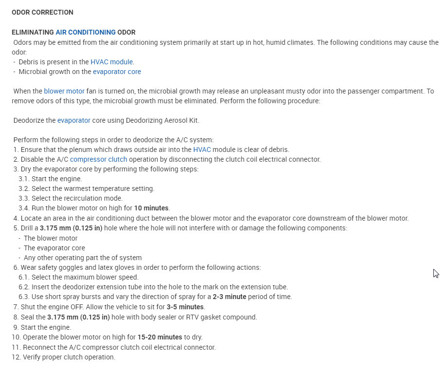

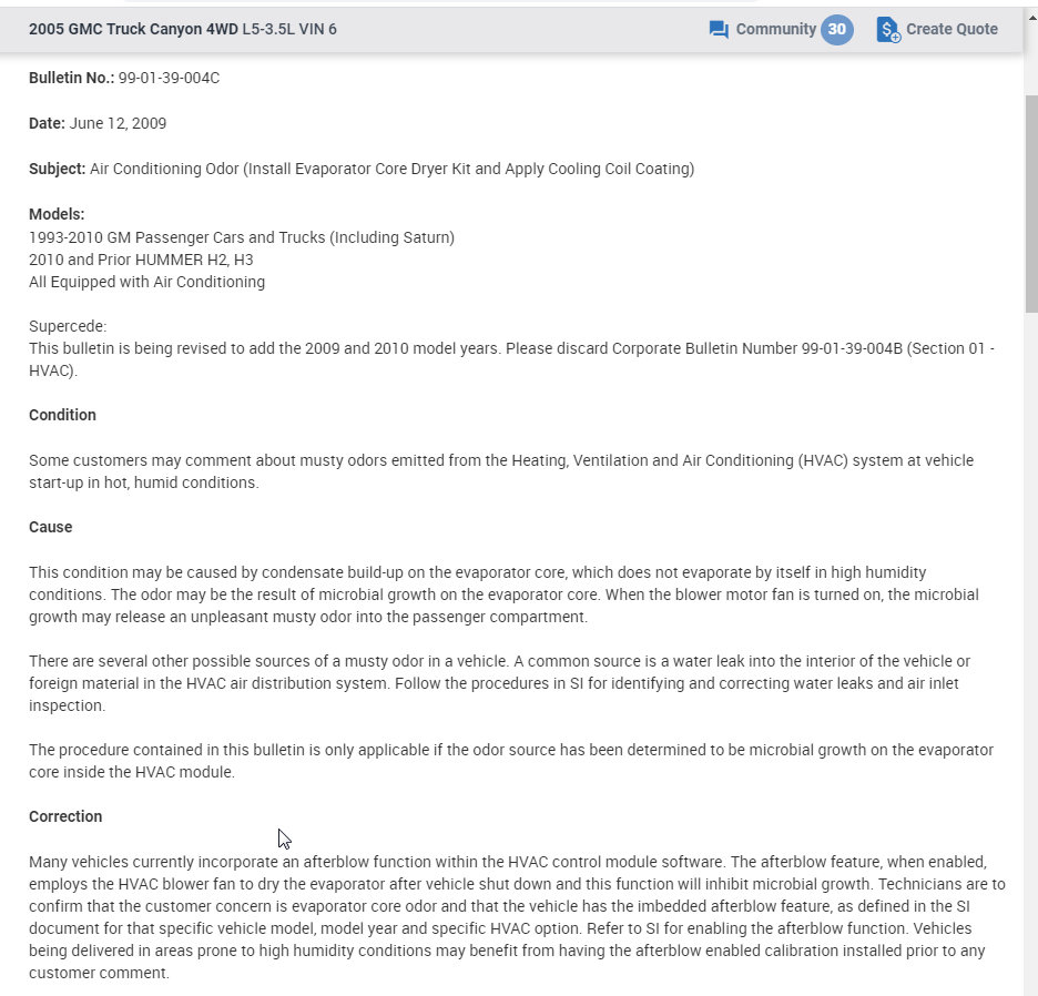

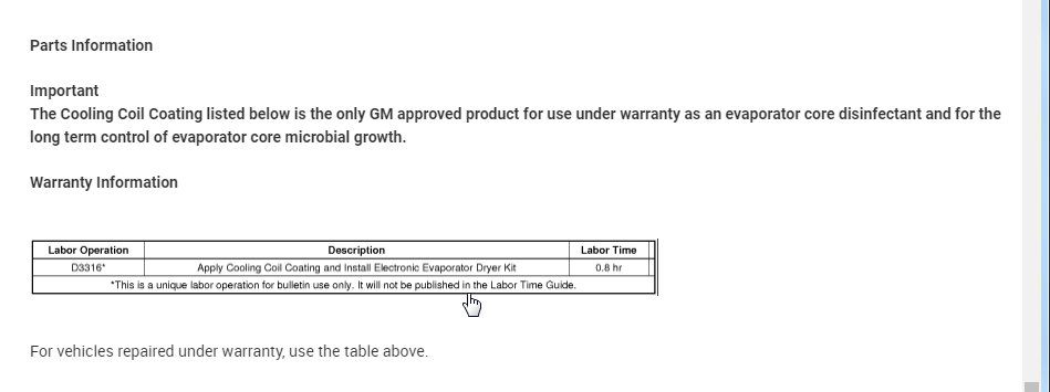

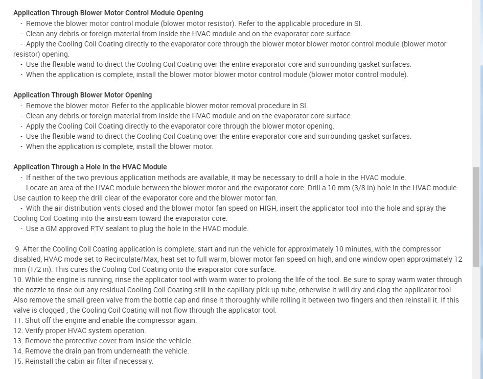

Correct. This vehicle does not have a cabin air filter however, GMC was aware of this so they have a couple different procedures to address the odor issue. I attached them. First is a TSB and the last page is the service manual process for eliminating odor.
Please let us know if there are questions. Thanks
