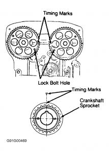

THIS IS A 1993 ASUNA SUNFIRE WHAT IS THE TIMING ORDER? ITS A 4 CYLINDER 16VALVE DOHC![img:0410dc4bcf]http://www.2carpros.com/forum/automotive_pictures/582576_41657_587457058_9973_q_1.jpg[/img:0410dc4bcf][img:0410dc4bcf]http://www.2carpros.com/forum/automotive_pictures/582576_41657_587457058_9973_q_2.jpg[/img:0410dc4bcf]
I DONT KNOW WHO MAKES THIS CAR SO I TOOK A GUESS THAT GM DOES SORRY.JUST CHANGERD THE TIMING BELT ! THERE IS TIMING MARKS ON THE TOP 2 CAM PULLIES AND A SMALL HOLE ON THR CRANK PULLY!IS THAT THE ONLY TIMING MARKS AND WHAT IS THE TIMING ORDER THANK YOU .

The 92 Isuzu Impulse and the Geo Storm are the same engines.

1993 ASUNSA SUNFIRE 1.8 TWIN CAM DOHC 16VALVE.OK GREAT BUT YOU STILL DID NOT ANSWER MY QUESTION WHAT IS THE TIMING ORDER THANK YOU FROM THE CAM 1 TO CAM 2 -CRACK PULLY.I STILL DONT KNOW THE TIMING ORDER THANK YOU. SHYANNE
Oct 13, 2010 at 1:24 AM
OBXAUTOMEDIC
  • 3,711 POSTS
OOOPPPPS Sorry....
https://images.2carpros.com/forum/automotive_pictures/188069_timingmarksSUNFIRE_1.jpg
