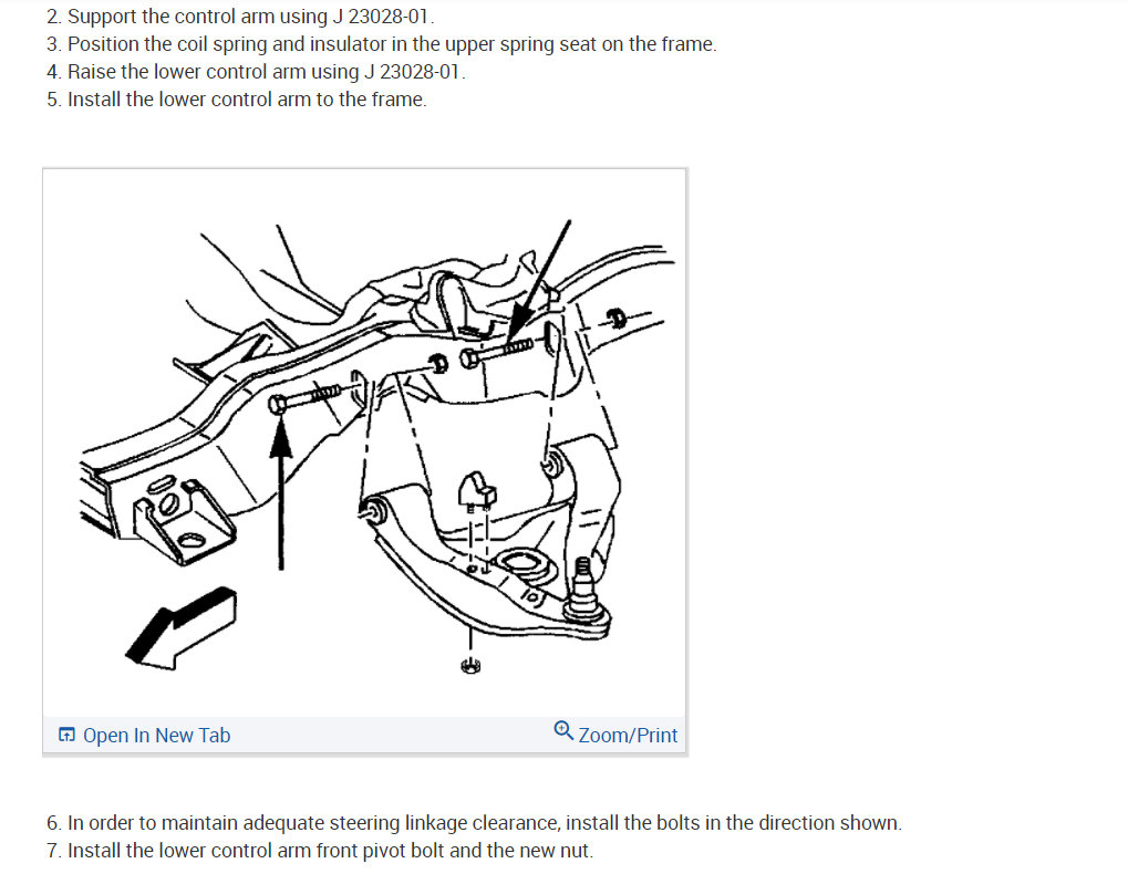

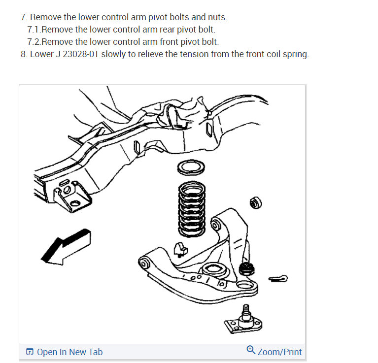

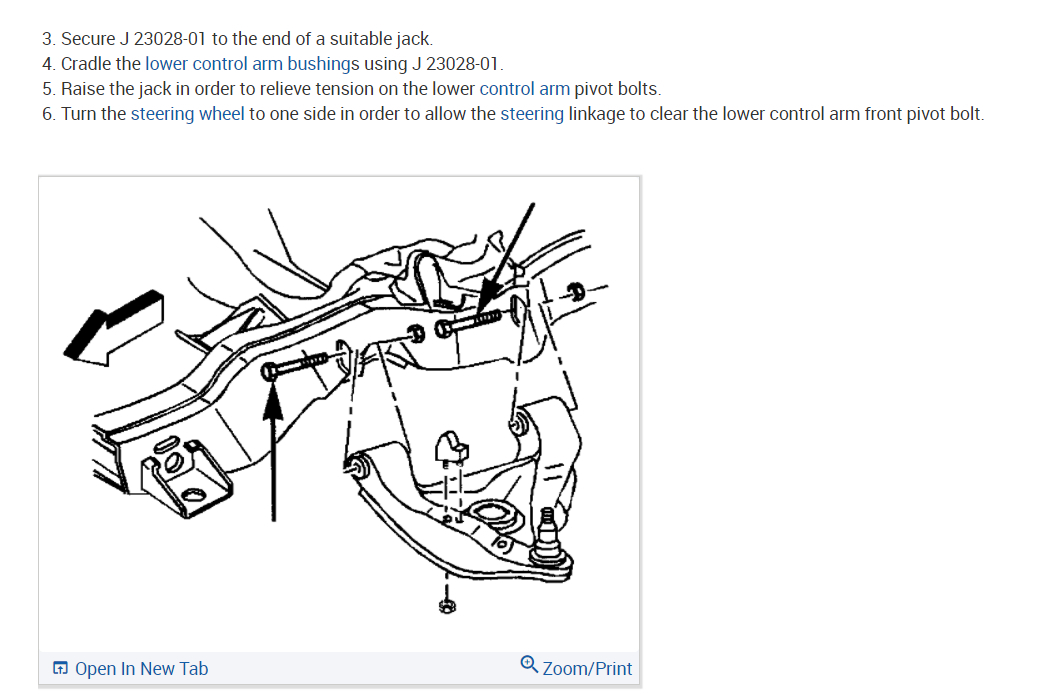

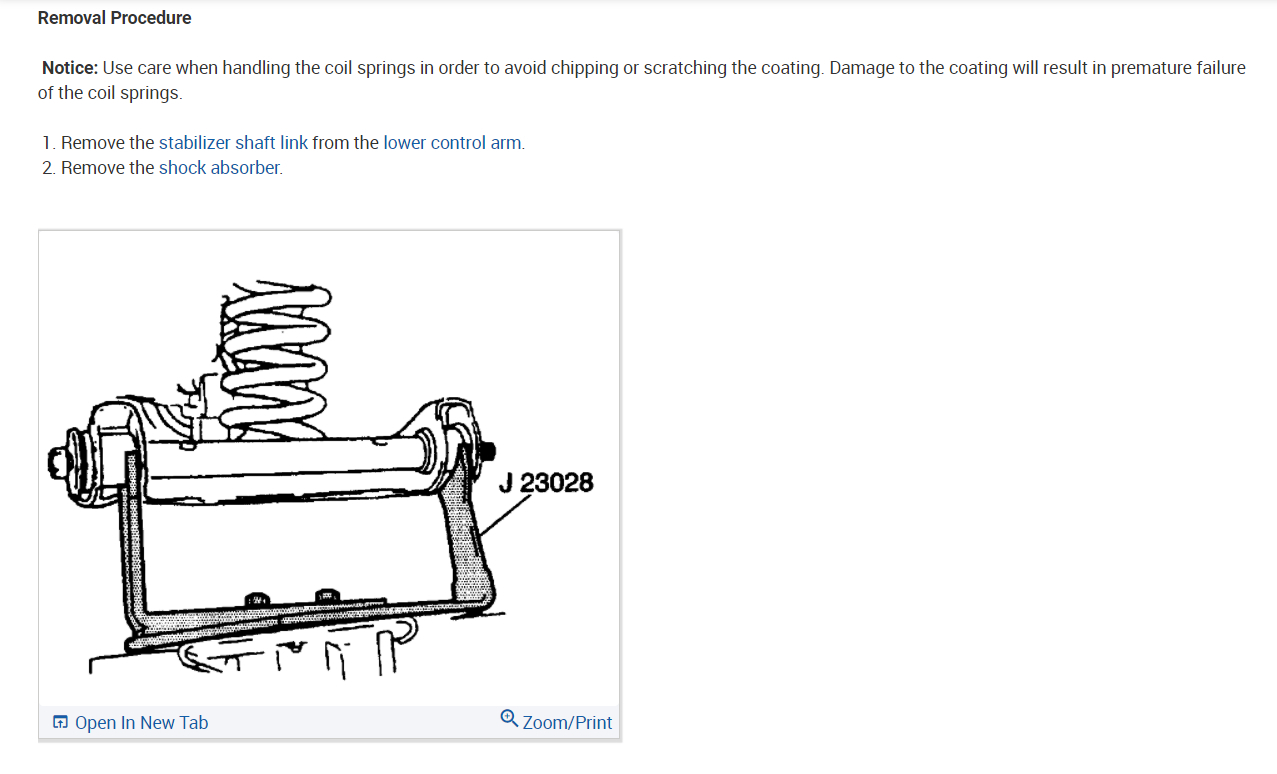

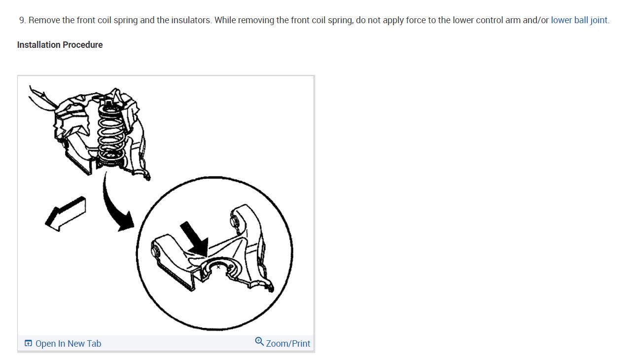

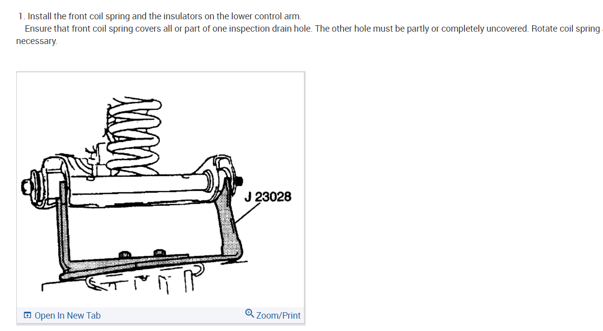

Good morning,
The torsion bar is only with 4 wheel drive models. You have a coil spring suspension.
It most likely is a worn-out coil spring. I attached the procedure for you for replacing the springs.
May 16, 2021 at 4:50 AM
