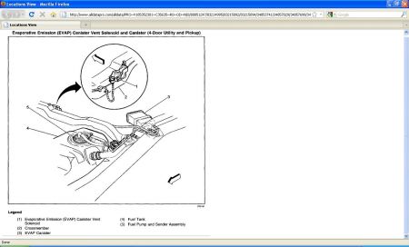

where is the vacuum hose canister located on this truck?
Oct 17, 2010 at 9:27 AM
SATURNTECH9
  • 30,869 POSTS
https://images.2carpros.com/forum/automotive_pictures/416332_2001_gmc_jimmy_canister_1.jpg
There you go.

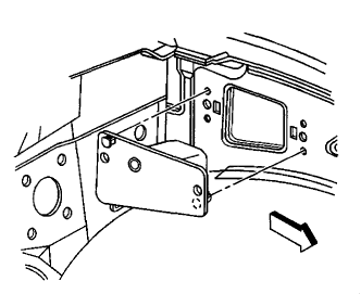

I believe your looking for the vacuum reservoir for the A/C. It's inside the left side fender near the brake booster.

Do these ever go bad? I broke the nipple off of mine trying to get the line off of it.
Jul 10, 2020 at 9:52 PM
DANNY L
  • 5,648 POSTS
Hello, I'm Danny.
After time and general weathering yes they can become brittle and break.Best to just replace but if trying to save time and money you can go to a home repair,automotive,or hardware store and look for a plastic type epoxy glue and try to reattach.Hope this helps and thanks for using 2CarPros.
