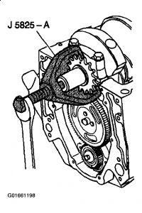

Have been working on replacing my timing chain, i have everything torn apart but i can not get the crankshaft pully to come off. I have used a three finger pully and only the outer ring of the pulley has come off, stiill the center piece wont come off. any suggestions?

the crankshaft sprocket will come off using service tool J 5825-A . is this what you already tried?
https://images.2carpros.com/forum/automotive_pictures/261618_Graphic_171.jpg
