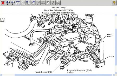

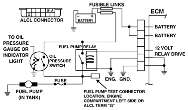

hi had a question before just have an inquiry about where the pressure regulator is located and how do you check if it is working properly or not. I have gotten the car partially started but it will not stay running at all but it tries. It kicks over but it seems as if its not getting a constant flow of gas. It reaches the engine kicks and starts but off it goes.

Try the oil pressure sending unit/sensor this is the one that powers the fuel pump after it starts up. See below
https://images.2carpros.com/forum/automotive_pictures/12900_oil_1.jpg
https://images.2carpros.com/forum/automotive_pictures/12900_oil_sending_unit_and_fuel_pump_circuit_45.gif
