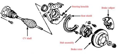

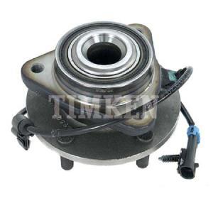

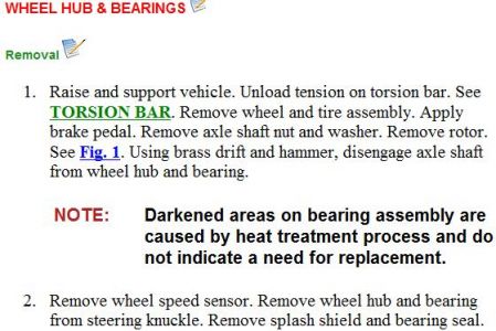

I have to replace the front wheel bearing on my jimmy. Is it a hub assembly and is it difficult to do.
