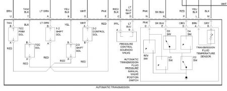

im trying to find a color coded wiring diagram for the main transmission wiring harness. my trans. is a l460e. it has a 13 wire connector and i dont know how to rewire it without the color code. please help

Welcome to the forum. I'm not a tranny specialist, I found this.
https://images.2carpros.com/forum/automotive_pictures/170934_jimmy_tranny_1.jpg
