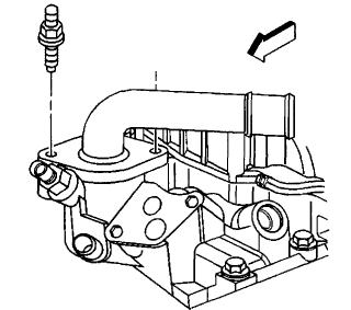

Heater problem
2000 GMC Jimmy 6 cyl Four Wheel Drive Automatic
we know to know where the thermostat is located
Dec 14, 2009 at 4:21 AM
  • 75,992 POSTS
https://images.2carpros.com/forum/automotive_pictures/12900_s1_1.gif
Remove the necessary coolant from the radiator. Refer to Draining and Filling Cooling System. Remove the air outlet duct. Refer to Air Cleaner Outlet Duct Replacement. Remove the throttle body bracket. Refer to Throttle Body Assembly Replacement. Remove the thermostat housing mounting bolts.

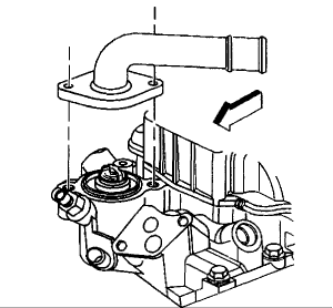

https://images.2carpros.com/forum/automotive_pictures/12900_s2_1.gif
Remove the thermostat housing from the lower intake manifold and set aside. Remove the gasket or O ring. Remove the coolant thermostat. Clean all the sealing surfaces of the coolant outlet. Clean the sealing surface on the lower intake manifold.
