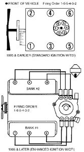

I just changed the plugs and wires and I think I may have crossesd some wires can you tell me how to do this properly? The engine is kind of "chuggy" now and the service engine soon light is now on.
+1
Tuesday, July 28th, 2020 AT 12:53 PM (Merged)
SERVICE WRITER
  • 9,123 POSTS
VERY easy to do.
https://www.2carpros.com/forum/automotive_pictures/30961_43_2.jpg
Check it against this diagram.
