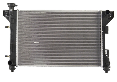

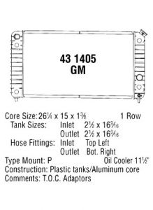

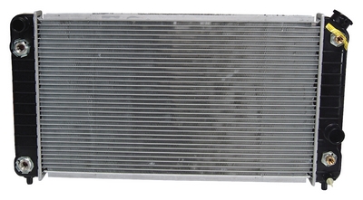

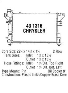

will a 1992 dodge dynasty radiator fit in a 2000 gmc jimmy

Different size. Wrong hose placement, to say the least...
