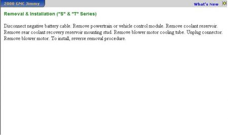

2000 GMC Jimmy 6 cyl Four Wheel Drive Automatic
I need to replace my blower motor as it ceases up on occassion and I need to hammer it (tap) to get it going again. I need to know the process to remove the old one and install the new one/

https://images.2carpros.com/forum/automotive_pictures/55316_00jimmyheater_1.jpg
