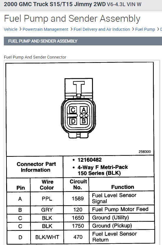

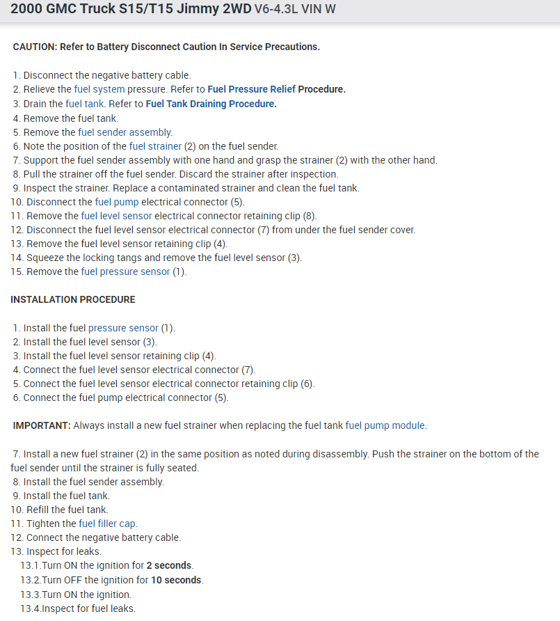

I have a 2000 GMC Jimmy. I just had the battery replaced. Tried to crank tonight on an incline and it would turn over but wouldn't stay cranked. I rolled it back down the small hill and it cranked right up on flat surface. It had plenty of gas too. What could it be?
Apr 20, 2010 at 1:54 PM
SQM
  • 6,383 POSTS

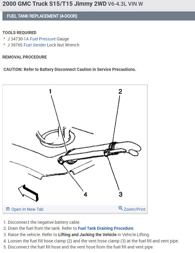

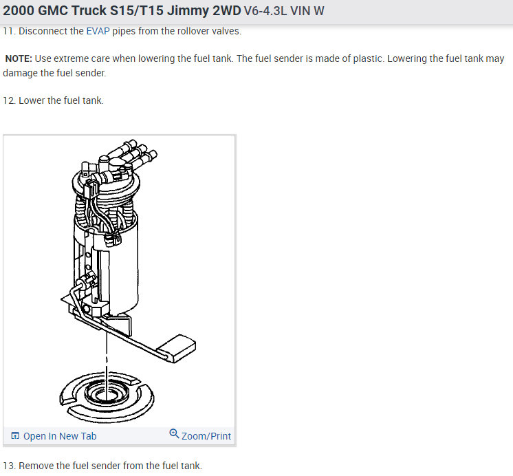

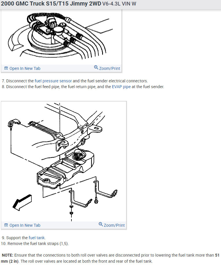

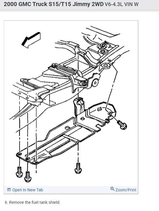

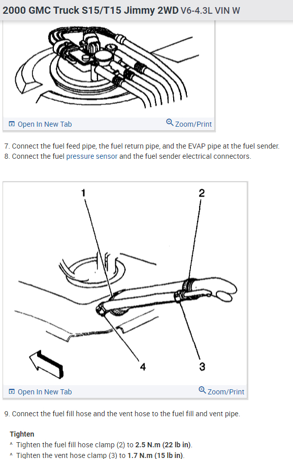

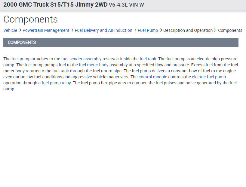

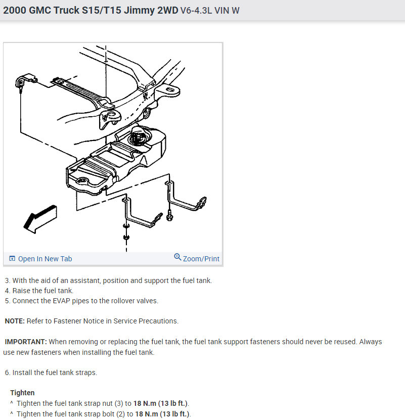

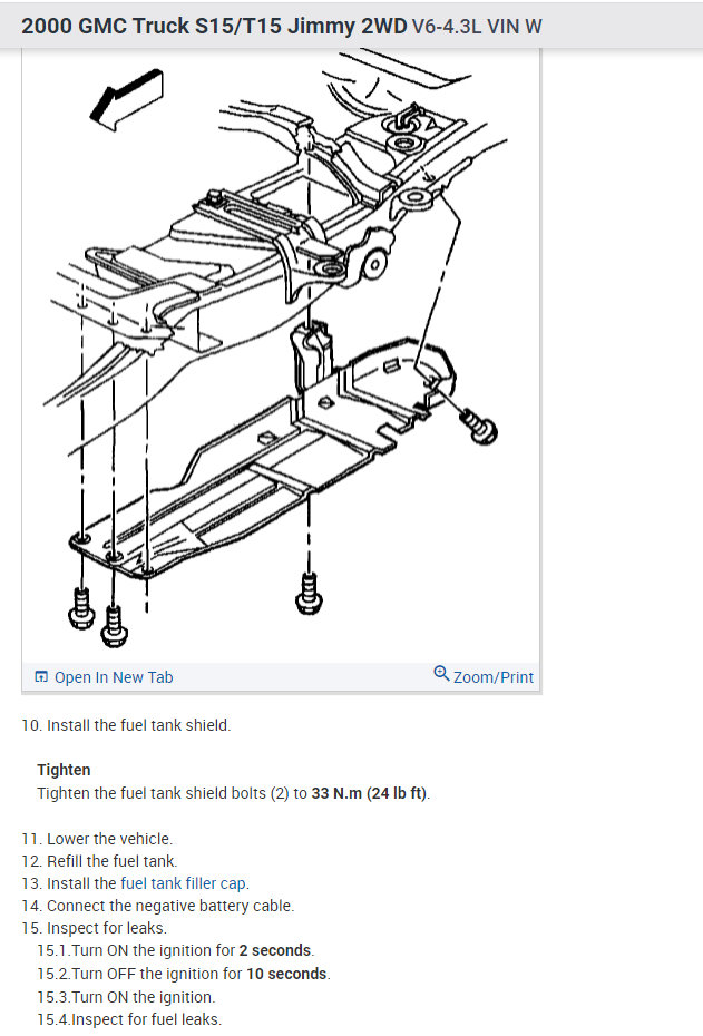

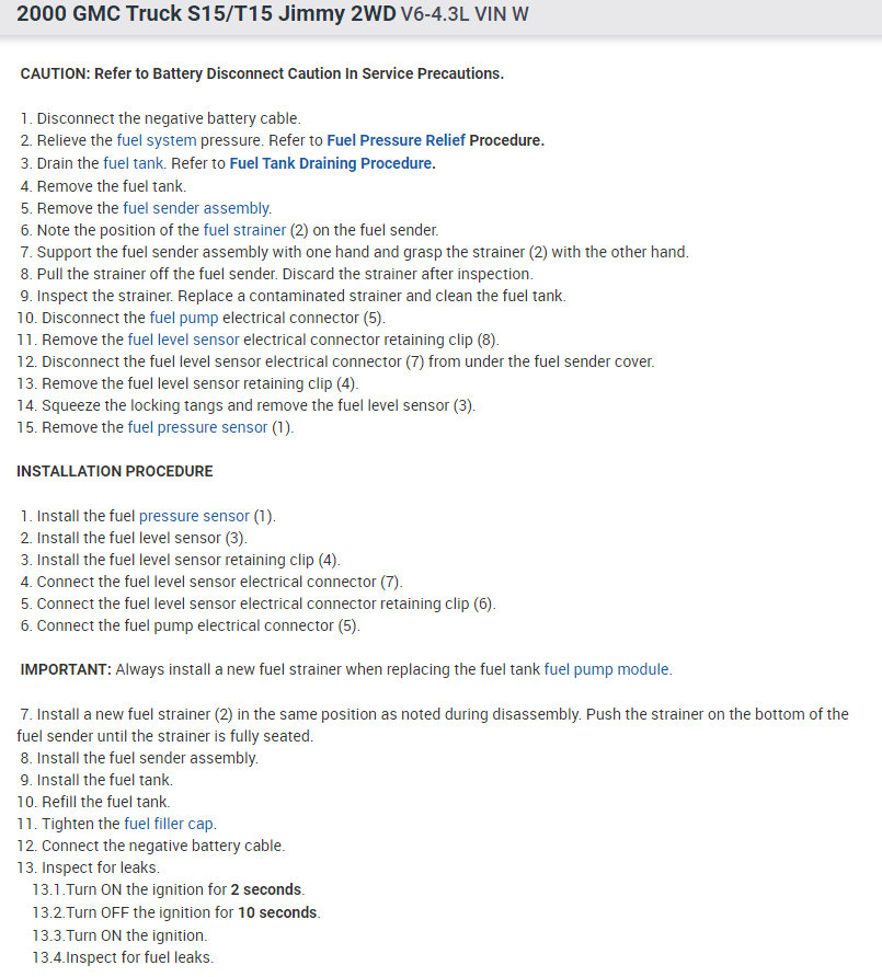

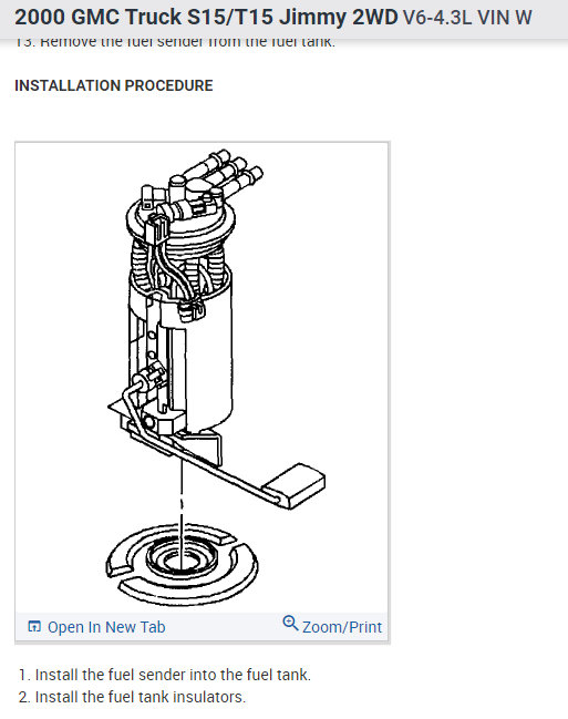

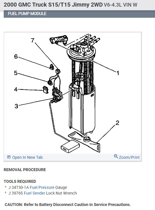

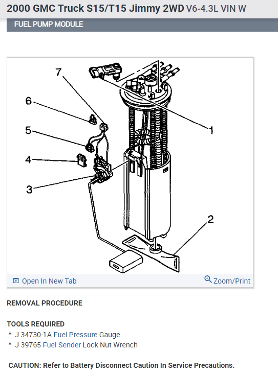

It does sound like when you are on an incline the fuel pump is unable to pump fluid to the engine. It can happen even if you are partially empty. Just about when the pump in no longer submerged in fuel you can have this type of no start. There is a check valve inside the fuel pump, intend to keep fuel in the pump in case like this. But over time it will leak and there will be no fuel to start the engine. Typically if the vehicle has been siting for a long time this tends to happen.

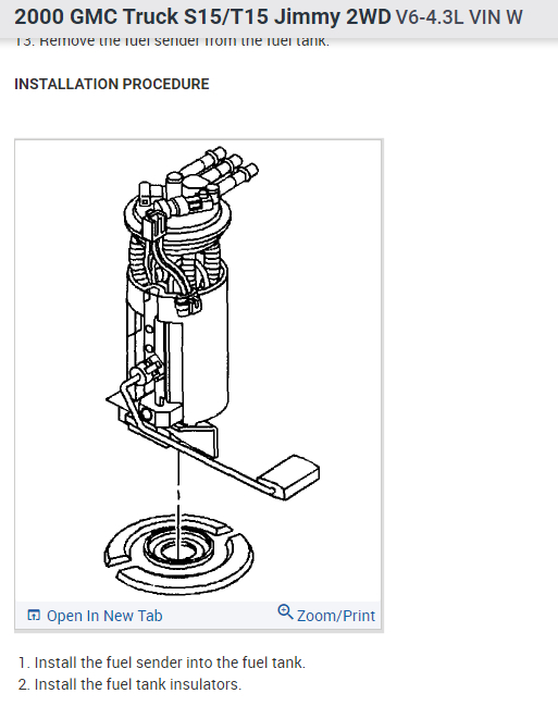

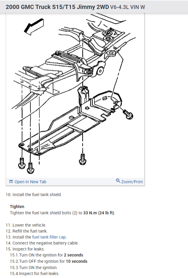

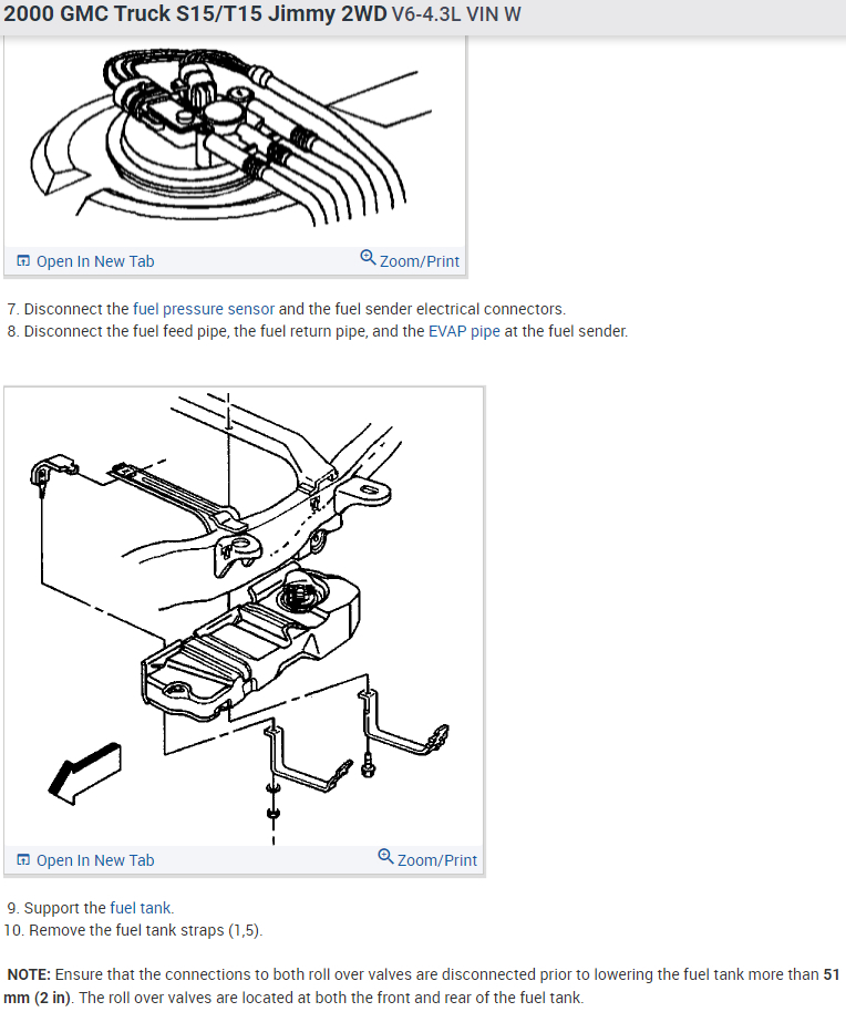

This check valve is a part of the fuel pump assembly and to replace it you will have to replace the pump.
https://www.2carpros.com/articles/how-to-replace-an-electric-fuel-pump
