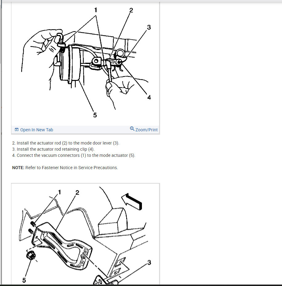

When I turn my mode switch from max, A/C, or bi-level to heater blend or defrost, air only comes out of the dash vents. It won't switch to defrost or the bottom vents. If the car is started with the switch in heater or defrost mode sometimes it will come on but as soon as I switch to air or max air, it won't switch back.
Sunday, August 2nd, 2009 AT 4:54 PM

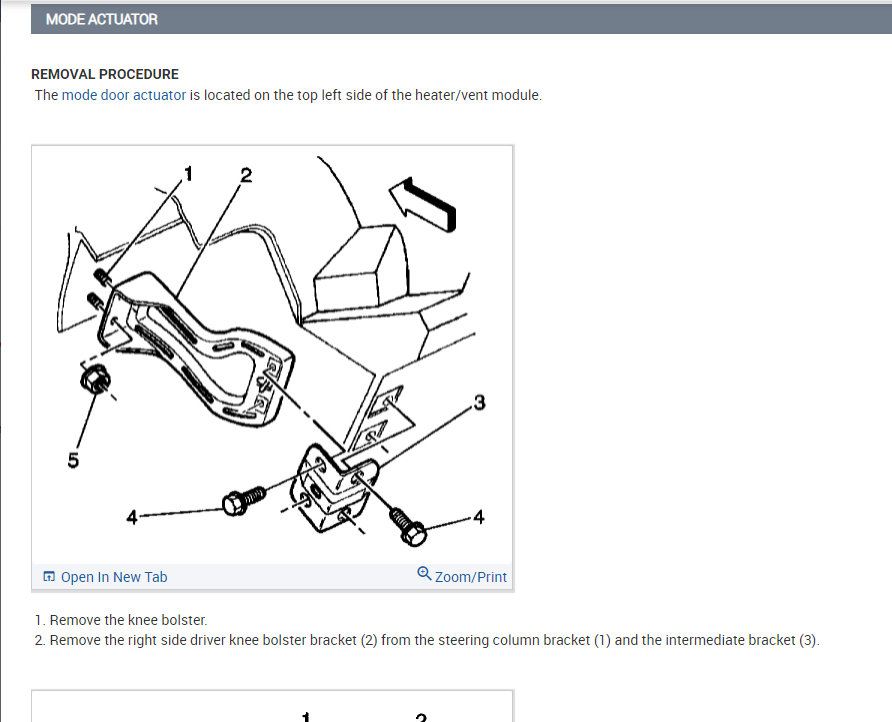

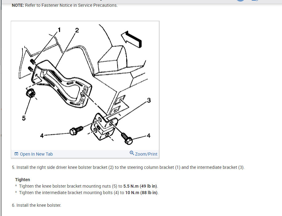

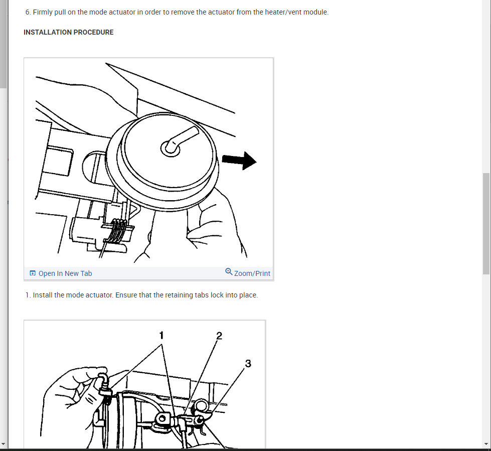

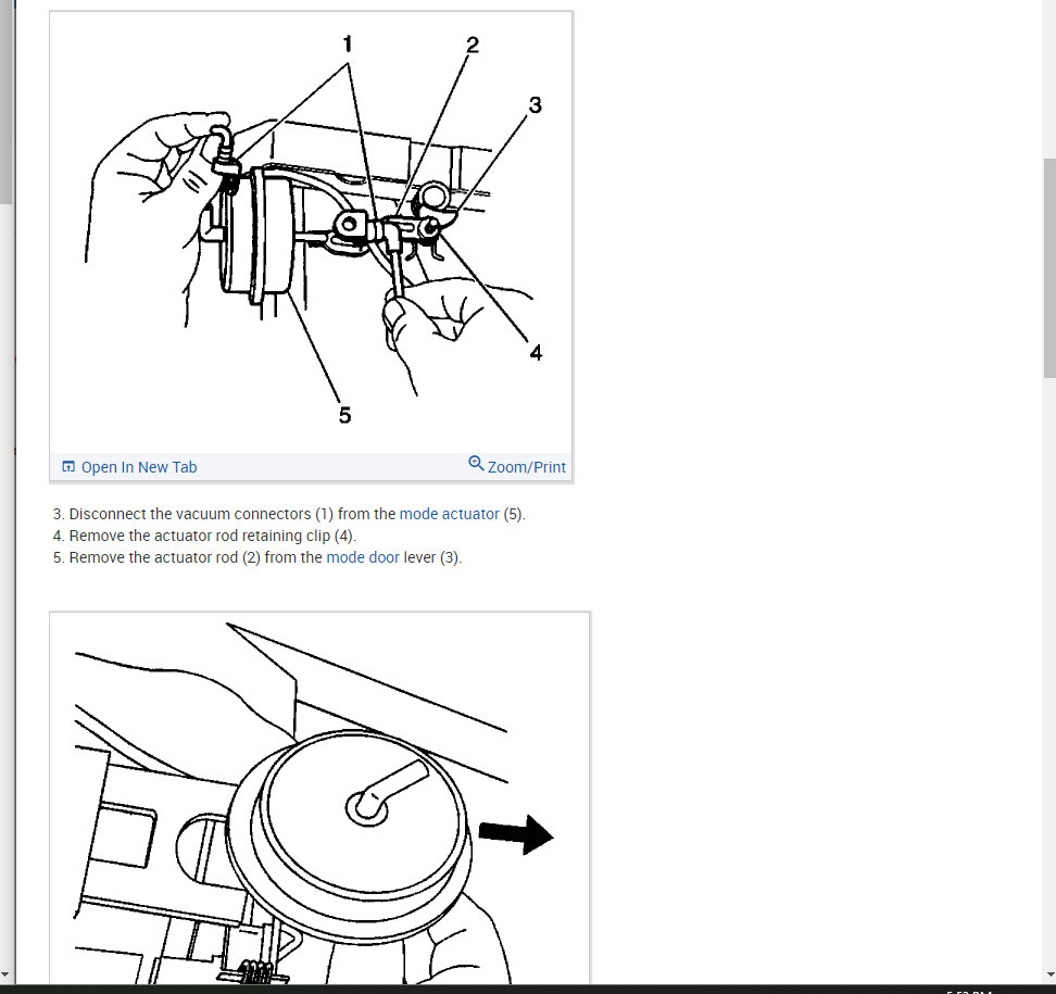

The issue with this is the mode door actuator has failed or the vacuum line has come off.
Here is a guide that will help with this:
https://www.2carpros.com/articles/air-vents-stay-in-the-defrost-position
Basically we need to access the door and use a vacuum pump and connect to the line and see if the actuator changes position. If it does then you have a vacuum line or source of the vacuum is the issue.
If it does not then this actuator is the issue.
Please run through this info below and let us know if you have other questions. Thanks
