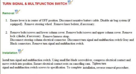

the turn signal handle got broke off.that means turn signals,bright lights ,wipers and crusecontrol is gone. how do ni replace that part of jimmy
