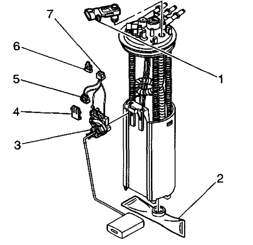

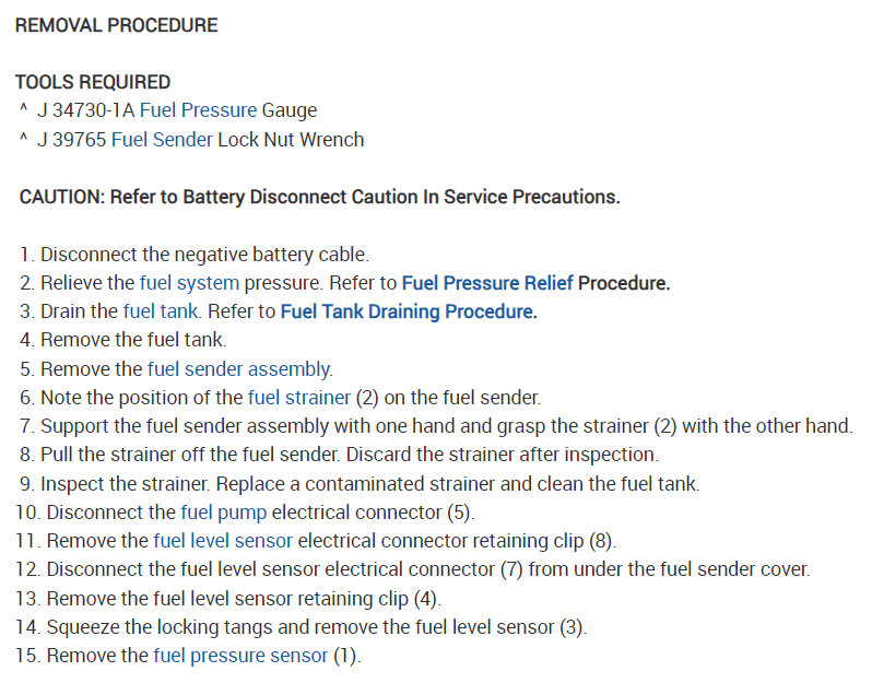

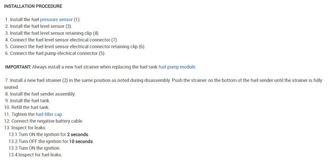

Yep, you should be okay, but I can tell you I would drop the tank and replace the fuel pump, one time the pump will not work even with tapping the fuel tank. Here is how to do the job is done in case you want to fix it:
https://youtu.be/bCcueO4ALxQ?si=0zIhliEyQYcLfuKv
Check out the images (below). Let us know if you need anything else.
